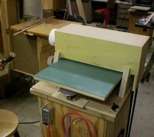

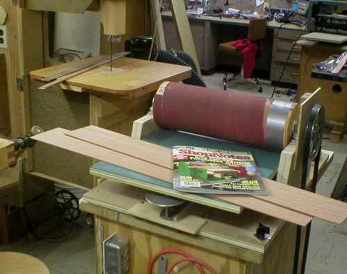

I finally finished my drum sander this morning.
I started out using the ShopNotes magazine article about building a drum sander (that issue's still on the newsstands now), but ended up changing a few things. I'v got manual feed (with plastic laminate on the bed to keep the friction down) and it works just fine. I didn't have a long enough piece of sanding roll, but taping on a short piece works for now.
That's a pair of sapele sides - the first pieces I ran through it. They came out pretty good - just need a minute of scraping to smooth out the 80 grit surface.
Only another dozen machines and jigs to go....

Phil!!!!!!!is this a home made bandsaw i see at the back there? Did you build it?!!!!!am i dreaming?
Nice, very nice drum sander sir! what kind of motor you got on there?

[QUOTE=Serge Poirier] Phil!!!!!!!is this a home made bandsaw i see at the back there? Did you build it?!!!!!am i dreaming?
Serge[/QUOTE]
Yup. I make it about 15 years ago.
The bandsaw's got 18 inch wheels and 12 inch resaw capability. I used it to resaw those sapele sides out of a nice piece of 4/4 sapele from my local Woodcraft - I sliced it into four pieces. I'm going to cut the next piece into 6.
I've also made an oscillating spindle sander and a 6x48 belt sander ( all basically wood.)
The drum sander is mounted on my router table and I mounted the motor for it into the side of the router table cabinet near the bottom. I just have to take off the belt, and a couple of hold-down screws and lift it off, to use the router table
It's a 1/2 HP motor from an old 7 inch table saw. It seems to have enough power for now, but I haven't tried sanding anything wider than the sides yet.
Phil

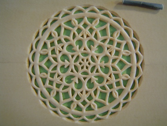

Joshua, here it is nearly finished. Just got to work it down with finer grit sandpaper rolls (my new best friend) then sand the paper off of the back side and refine the back edges.

Colin - thats incredible! Please keep the lute updates coming!
Instagram: @jfrenchluthier
PostPosted: Mon Apr 24, 2006 2:11 am
That is just awesome, the detail is incredible, you are a Luthier of the highest order.
